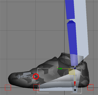

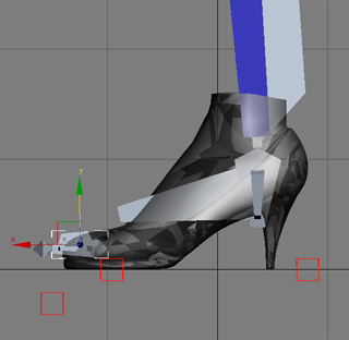

In T-Pose, the shoes of the male and female characters are respectively flat and high-heeled as shown below:
Male character with flat shoes. |
Female character with high heels. |

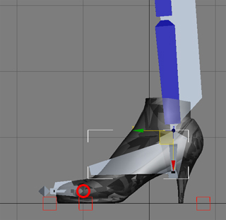

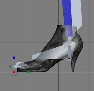

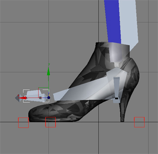

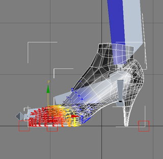

You are only allowed to adjust the relative position of the Toe and Foot bones; and manually modify the height of these two bones according to the the tip of the shoe.
Before skinning the high heel meshes to the bones, you need to follow the steps below:
Note: |

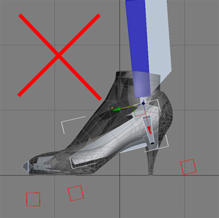

Never directly rotate the Foot bone to fit into the shoes meshes because you may
cause the local x-axis of the foot bone to misalign. Remember that it needs to maintain a position perpendicular from the ground. ![]() |
