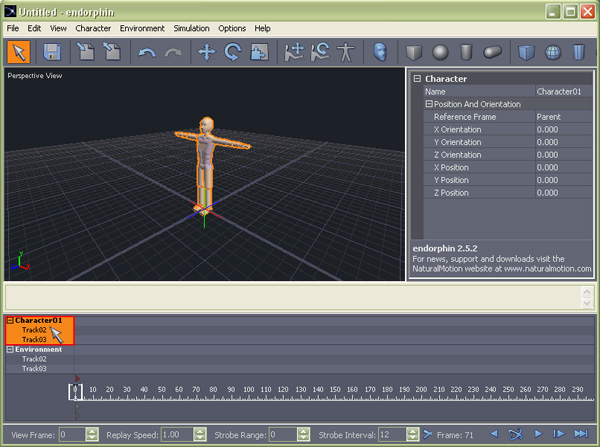

			- Launch up Endorphin.
			- Click on the "Character01"
			in the "Timeline Editor". This highlights the character
			that is applying the motion.
			- Noticed that when you select the Character in the Timeline
			Editor it has multiple tracks for you to use. With the ability to
			create layer animation you can easily combine various motions to the
			character and make it into a series of motions.

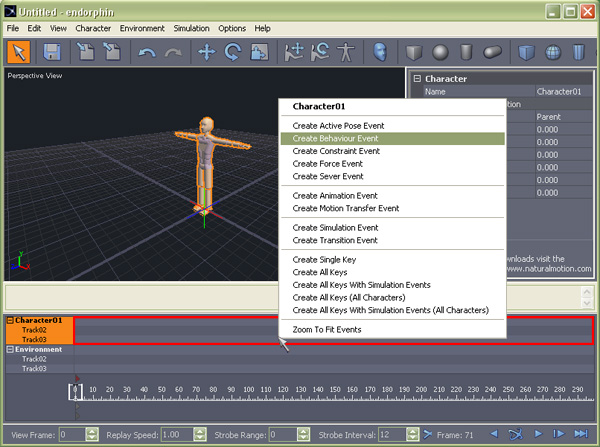

			- Add a behaviour to
			the character by clicking Character > Create Behaviour
			Event or you can even click the "Create Behaviour Event"
			button
  in the Main Toolbar. Alternatively, right-click on the
			Character Timeline area which is highlighted in the red box for the
			context menu.
			- Once you have select
			"Create Behaviour Event", a new timeline marker appears on the
			Timeline Editor. The color changes to orange when the timeline
			marker is in selection.

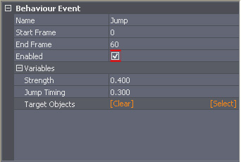

			- With the behaviour
			event in selection, search to the side "Behaviour Event" of
			the Property Editor.
  In the "Name" section it
			indicates which behaviour is currently on the character timeline.

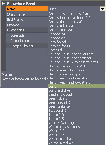

			- How about applying a
			new motion to the character? Let's apply "Jump" to the actor.
			- Now that jump has
			applied to the character timeline.

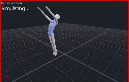

			- Click "Simulate"
			button
  to
			preview the behaviour event.

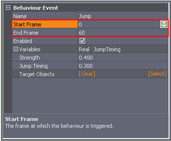

			- Noticed that we can
			set the "Start frame" and "End frame" of this behaviour
			event in the right side panel.
			- You may also adjust
			the timing by dragging the timeline marker's edge in the Timeline
			Editor. Dragging the left edge sets the start frame and dragging the
			right edge sets the end frame.
			- After you have
			modified the timing to the character. Click "Simulate" button
			or press "Ctrl+Spacebar" to preview your behaviour event once
			more.
			- Maybe some of you
			already had a question about the "Enabled" function in the
			property editor. This function allows you to compare each event when
			they are enabled or disabled. This controls whether or not this
			event influence simulations.

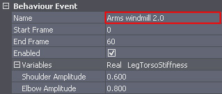

			- Try other behavior
			and examine how the character reacts.
